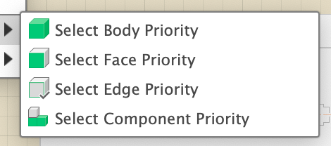

I have edge priority selected:

I can reproduce this behavior, but a clarification here:
  • Selection priority is (or should be) correlated to Selection Filter. If "Edge" selection priority is ON, what that does is toggles "body edges" ON and everything else OFF.
So that being said, Selection filters is the real culprit here. The two that are impacting you are Sketch Curves and Components. In your demo, Sketch Curves is set to OFF, so you can't pick the sketch edge you're trying to. Component selection is ON, so it's picking the top level component. This is what seems to be a little buggy - I can repro what you showed where if I click directly on the sketch curve while in sketch mode, it highlights the body that is contained in the top component.
