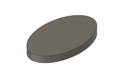

Hi guys, how to change the oval shape to square shape. what are the steps for that please see the image i want to change it to square shape. Thanks.

I don't see any rectangular shapes in your picture.  I see an extruded elliptical shape.  Do you want to turn that into an extruded square shape?  This looks so simple, why not just start over and create a sketch, draw a "square" (rectangle with equal dimensions) and extrude that?

Sorry this is oval shape. I want it square shape please can you explain in video how to do it? thanks

Hi it is oval shape sorry and i want it rectangular shape.

I would still like to understand why you want to do this, instead of just creating a new square and extruding it, in a different design.  But, here is one way to do it:

Thanks. I arrived to the step tangent please see the video then it does not allow me to tangent it?

it looks like you did not create the sketch on the face of the body, so the bounding edge (the ellipse) is not in the sketch.  You may have to Project it into the sketch to get it recognized.

I tried multiple times not working

For a tangential relationship, the ellipse must first be projected into the sketch.

thank you so much
