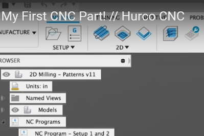

gtprototype
I was just watching a youtube video from 2020, the GUI used to be so much better.  I did a screen grab, have a look and see for yourself.
Dale Speakes
prototype technology

lance.carocci
@gtprototype that is the same UI framework we are using today.

gtprototype
Yes, same UI frame work, perhaps you haven't noticed how it's been made harder to see by reducing the contrast and changing the font?

HughesTooling
@lance.carocci  If you look at the screengrab above (post 5)it looks like all the text is in bold. Don't know if that's down to the resolution but definitely a lot clearer than what I have. But looking back at some old screengrabs I have it doesn't look like any changes for several years.
This is what mine looks like but a different screen res will probably make it look different.
This is from the screengrab in post 5 and you can see the manufacture label looks the same as the menu labels.

lance.carocci
I see - would the UI in the video happen to be from a Mac? That looks like Lucida Grande, the macOS font added circa ~10.9 Mavericks. This font is not available on Windows, so that client uses Arial. I believe the Windows client briefly used Tahoma in the early days, but was dropped due to alignment issues with corresponding .
The aforementioned UI framework project will also address that, likely unifying the platforms under Autodesk's Artifakt typeface.
Also, from the looks of your UI you have debug mode enabled. If you encounter any weirdness, I recommend turning this off - it is not intended for end users, purely to shortcut some internal testing workflows.
