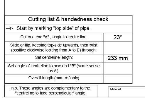

I have created a 7-row table in my drawing template: the fixed text has font sizes 3.5, 3 and 5 rows of 2.5 mm.
I then made a drawing (of just a simple body) using this template: the table looks like this.  OK so far.
The initial document text height is 3.5 mm:
I then changed this to 2.5 mm but found that the text heights in the table (which are set individually in the template) changed:
The text heights have now changed themselves to 2.5 (as document setting), 3 (as before), 2.5 (as before), 1.786, 3 rows of 2.5 mm (as before).
Changing the document text height back to 3.5 mm does this:
The heights are now 3.5, 4.2, 3.5, 2.5, 3.5, 3.5, 2.5 mm
I'm sure it is not meant to do this!
I would attach a file but I'm not sure how to export a drawing to a suitable format for posting here.
Roger
