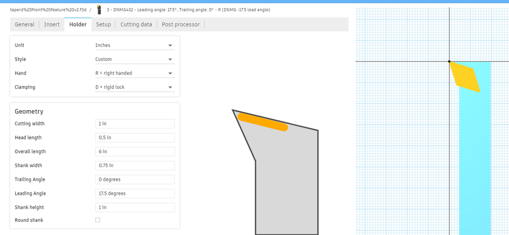

I am trying to generate a good toolpath for a feature on the face of a part I have to machine.
The OD of the part is 9.1"  starting at 7" the face has a tapered recess of .058" ending at a center drilled hole.
I was able to generate a problematic toolpath using a CNMG tool and using tons of passes to thin the chip.  When I switched to a 17.5deg offset DNMG tool  I lose the toolpath.

Seems to be a problem with the tool setup. Although you've set a 17.5°end relief the tool ends up with no side relief.
Setting up a custom style and setting the leading angle to 17.5° seems to work. @seth.madore  this looks like a bug, there's an option for 5.0° on both faces (no good for this tip) but noting for 17.5° on both faces.

@tgford58  Just noticed you need to set the trailing angle to -17.5° and the leading to 17.5° to get the correct reliefs on the holder you have.

Edit. Just to be clear the problem is for this tip you should have an option for 17.5° side and face. There is an option for 5.0° Both but that makes no sense with this tip.

That change seems to generate a toolpath that meets the feature.  Thank you.

I see the problem now. The tool has no clearance on it so you get a collision.
If you're sure the actual tool will work you can work around this if you set the tool as a round shank.

The tool has a -5 deg rake so there is adequate clearance.
It seems that Fusion hasn't taken into account that tools can come in larger offsets that 5deg.  It seems like a ton of work around especially in the lathe area.
I will just let the simulation show red.  It is fairly common on lathe tool paths to show collisions when none occur.  At least that is my experience.
