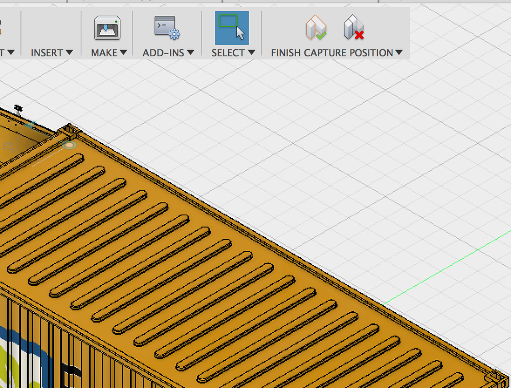

Just to check - are you trying to edit a capture position marker in the timeline? This is denoted by an orange symbol and is the timeline marker after you capture the position of a move component. I am just trying to differentiate if you are moving a body or a component - as editing a move body should bring up the Move dialog again.
If you are editing the capture position, what happens here is you are allowed to move the components again to where you want them, and once done you need to capture position again, or cancel. I will admit, it sneakily pops up in the top-right corner of your ribbon after you edit the capture position.

Ah, yep, so that is what I was referring to with a "Capture Position" (sorry old terminology). So if you right-click and edit this from the timeline, what actually appears in term of dialogs is at the top-right of your ribbon (see my screencast from my last post). While you are editing this position, you can either move the component again and when done click the green check mark (Accept Position Edit) , or if you do not want to make any changes you can click the Cancel Position Edit.

Ah ,yes James! I do get the options to 'Accept' or 'Cancel' as per your earlier screen capture. I had not noticed this change as I was expecting the normal 'Move' dialogue box.

Having highlighted the operation, clicked 'edit', then the top menu line appears as per your screen grab. The component that was the subject of the series of 'move' actions which were originally accomplished by combinations of both manipulators and numeric values, is highlighted.
In this state it can be 'picked' and moved in what I suspect was the last axis of the original group. However, as there is no dialogue box on the screen for axis selection, move type, or numeic value, there is nothing by which anything else can be accomplished.
