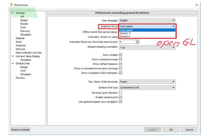

Every time I try to create a drawing it goes to the drawing screen and locks up. I can still zoom and move around but cannot click anything. I cant even close the drawing or switch back to my model. And my cursor is a giant cross. I uninstalled fusion and reinstalled with no change. My graphics driver is an intel HD graphics 530 which is up to date.

just try another graphic driver setting

I tried changing that with no luck

Perhaps try reducing the load on your graphics system via this helper page. I have seen other posters solve by:Slow_performance_and_freezes_when_working_in_any_workspace_in_Fusion.jpg
https://www.autodesk.com/support/technical/article/caas/sfdcarticles/sfdcarticles/How-to-optimize-se....

Hey, thanks! Although I had to UNCHECK that and then everything worked!
