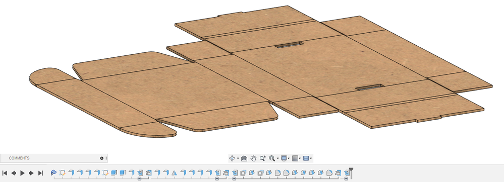

Can't unfold my part completely... Can someone solve this issue?? thanks

You have a very small Bend Radius in your sheet metal rules:
This with k factor of 0.44 has made problems like this:
Change K Factor to a smaller value and it will work. I used 0.1 and could unfold:
