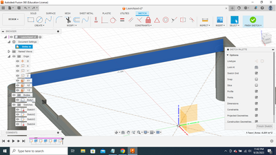

I'm trying to take a square notch out of a rectangle wall but I can't seem to get the right plane after selecting the face. You can see from this screen grab, I did one notch OK but trying to do another one kitty corner is not working. I highlight a face, right click , select Create sketch and then my rectangle tool. The rectangle tool proceeds to draw the rectangle 90 out on a different plane than the part I first selected.

You don't necessarily need to sketch on a face of the Solid body. Can you share your Fusion 360 file?

1. The plane of sketch 4 is on the X/Y plane.
2. Since the sketch has no content yet, you can redefine its plane.
