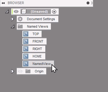

I'm having weird UI trouble today. I can't seem to click on a named view and change the name of it. It doesn't work anymore. Kind of frustrating... I can activate the saved view, but that's it

Just to make sure, you do know that you can only change the name of a "New" named view, the default ones cannot be renamed.  I also want to make sure that you know the new named view must be blue in order to rename it.  I always right click on it first, ignore the context menu, and then left click it again to edit the name.

I'm talking about custom new views... not the defaults.

So am I, read my post and look at the graphic.  I am creating an New Named View.  I was just making sure that you knew you could not rename default views.

There is seems to be UI refresh and UX mouse event capture issue?
novakLT3XW
I had the same problem, you MUST right click, ignore menu and left click on name - this is only possible solution.
Standard slow double click does not work - quite confusing.
