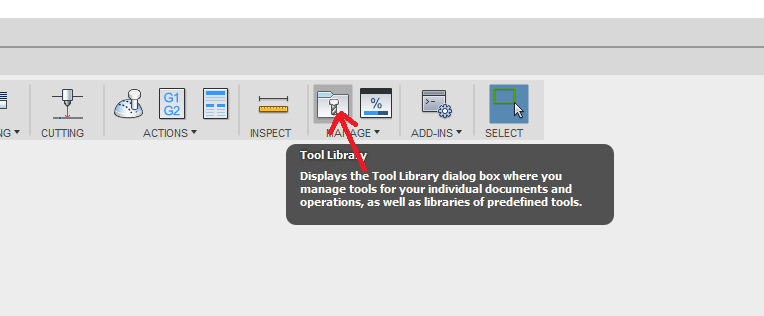

Hello
I seem to get more bugs lately, than i have been before and normally i think of fusion as a quite stable cad program, but lately i seems like every time i have to use it, there appears to be a new bug.
But back to my problem. I just wanted to go and do some CAM in fusion today, but when i tried to pick a milling tool, for surface milling, the tool library did not open. first i though the program crashed, since i could not cancel or anything, but i quickly found out, that i could just press escape, and i could then return to use the program again.
I have tried to reset the view to default layout and deleted the fusion folder in the localappdata location, but nothing seems to work.
I have also tried to reinstall fusion 360, did't work either...
Can you help me?

mads4ever
Hello Paul Thanks for your feedback.
The problem is that the tool library/manager window, don't even open. It's like it is there somewhere cause i can't press anything else and when i hit esc, it seems like the window closes and all things works again.
The problem is, that even when i try all the earlier mentioned solutions, the tool library/manager window won't show.
There is nothing to see in a screencast, cause nothing happens when i press the tool library/manager button.

Hi @mads4ever
Thanks for the response - that clarifies the issue. I have a few thoughts on this issue:
  • Does the tool library launch if you reset Fusion 360 to its default layout? It sounds like the tool library may be launching off the screen somewhere - this would take focus from Fusion until the Escape key was used.
  • This issue could be related a problem with cloud libraries - does the tool library launch if you disable cloud libraries? This option is in your CAM Preferences. Please let me know if disabling cloud libraries works to show the tool library.
  • As I've been unable to recreate this issue on my machine, I wonder if a clean uninstall/reinstall would help.
I hope this helps! Please let me know if you have any questions - if so, it may be helpful for us to have a look at your diagnostic log files.

I had the same problem but now it works. It seems that if you use fusion on a second monitor and then go back to using a single monitor this problem appears. Just go back to the dual monitor setup and the tool library will re-appear.
Hope this helps.
