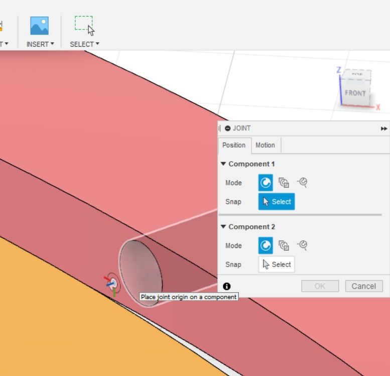

I can't get joint origins to snap to centre of holes any more, and it's winding me up lol.. I used to be able to hover over and it would snap to the centre of the hole, but now it puts the snap point out from the hole, for seemingly no good reason... What on earth is the problem with it please?..

SavedByTheLamb
Yeah, I dunno. Something is up with the circular pattern. Some were suppressed on purpose. I took off the suppression so holes go all around, and some I can get the joint to snap in the right place and others I can't. It's stressing me out, I give up for now, it's too late...

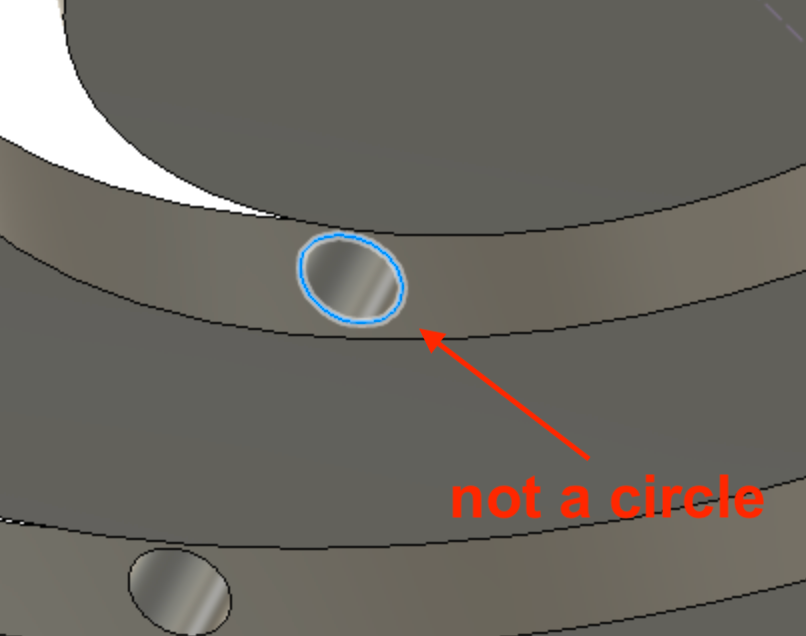

jeff_strater
@SavedByTheLamb - A couple of things:
  • you cannot snap to the center of the "circle" here, because it is not a circle - a circular hole through a cylinder produces a complex curve:

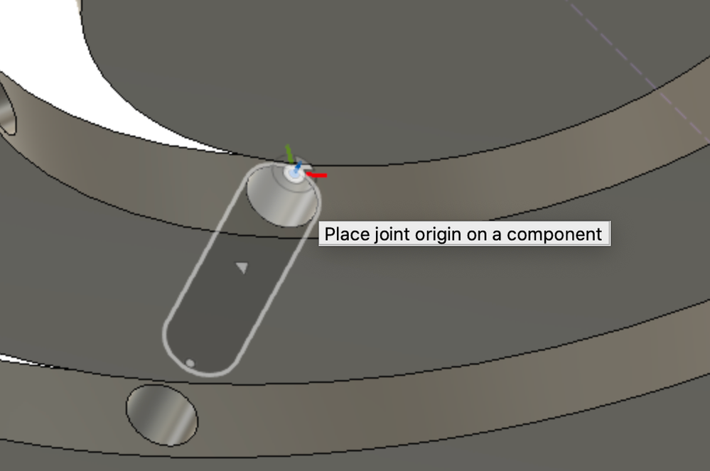

  • you can select the cylinder and snap to the endpoints of the virtual cylinder.
  • if needed, hold down CTRL (CMD on Mac) to "lock in" that cylinder, so you can pick any of the 3 snap points
  • note, though, that the JO is at the end of the "virtual cylinder", and will not lie in line with the face:
    so you will have to adjust the point so that it is closer to being in line with the faces

"You cannot snap to the center of the "circle" here, because it is not a circle - a circular hole through a cylinder produces a complex curve:"
This is going well over my head. I can snap to the centre point, and flush, on the originals. They are all circles so far as I can tell. It's not a circular hole through a cylinder. It's a circular/cylindrical hole through a load of rings...
(Edit: Sorry I think I just "got" what you meant about the circle not being a circle. Because the hole is cut out of a curved surface, not flat. But that makes no difference to the fact I can create a joint origin flush with the original holes, but not the copies of those same holes...).

jeff_strater
"This is going well over my head. They are all circles so far as I can tell. It's not a circular hole through a cylinder. It's a circular/cylindrical hole through a load of rings..."
I've forgotten the math here, but the intersection of two cylinders (your "rings" and "holes" are both cylinders) is not a circle.  It is, for lack of the proper mathematical definition, a "potato chip" curve.  Joint Origins can only snap to the center of a true planar circle.

"Why is the "virtual cylinder" longer than the actual hole?.."
I'm not sure how the extents of the cylinder are computed, but it is guaranteed to include all of the geometry of the trimmed cylinder.
"Do you mean you could get a joint origin flush to the face, on any of them?.. I can get a origin point on any, but the copied ones will not go flush."
I do not see any difference in behavior of the original or the patterned versions.  No, you cannot get a flush JO on any of them.  The larger the cylinder, the closer it will be, but none should truly be flush.

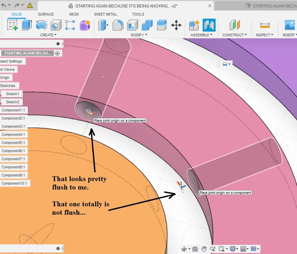

SavedByTheLamb
"No, you cannot get a flush JO on any of them. The larger the cylinder, the closer it will be, but none should truly be flush."
It may not be perfectly flush on the original hole but it looks like it is. It's probably as close as possible. Whereas the copy is way off... And both holes are identical in shape, so something else is causing the original to snap flush, and the copy to refuse to do so.
That picture is a merge of 2 separate screenshots while hovering the cursor over the hole, that is how both joint origins are able to be seen at the same time...
Message 14 of 15
jeff_strater
ah, OK, that helps a lot, and actually describes the problem pretty well, so thanks.  It all has to do with that virtual cylinder I described earlier.  It seems the virtual cylinder is much tighter on the original than on the pattern instances.  This is something we can look into, definitely.
