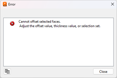

To break the problem down, I isolated the initial surface I was working with (see attachments). The goal is to thicken it by 5mm towards the outside, and close the bottom, just like I did in the previous file.
The easiest way to do it would be to use the Thicken tool, but it doesn't work with this surface. It throws an error as soon as I select the rounded part in the rear of the model. To circumvent this issue, I had created several offset surfaces, patched the open parts, and stitched everything with a high tolerance.
I made several new attempts, and was finally able to thicken the surface by re-constructing the rear part using a loft. Can you please take a look at it? Why is this workaround necessary to make Thicken work?
Then, I tried closing the bottom of the "fixed" model by patching the bottom before the Thicken operation, but the Thicken tool refuses to work again in this case.
Finally, I tried by first using Patch and Loft to close and stitch that part. This yelds a new body I tried combining with the fist body to close the bottom. The Combine tool, however, throws an error I don't understand.
I guess there's something weird going on with the curvature of my surface, but I don't understand what exactly.
Thicken tool error:
Combine tool error:
