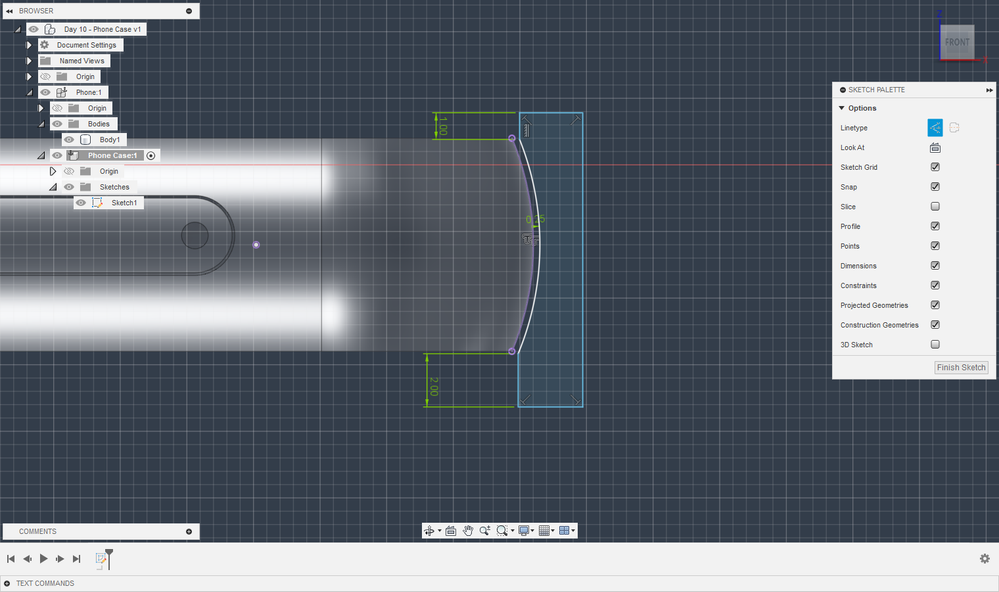

I'm currently in the process of learning Fusion and I've been struggling with this one.
My projected curve doesn't appear to be constrained as per the white line and I can't figure for the life of me how to constrain it.
Any guidance by someone who knows better would be greatly appreciated!

My apologies for not being specific enough. I'm not actually referencing to the purple projected line but the white offset arc. I'm trying to have full constraints (sketch red lock icon) but there doesn't appear to be a way to constraint it as far as I can see.

Absolutely! Thanks for offering to help. See attached.

The arc, is also somewhat constrained, being White.
The sketch has three blue articles that you need to address, before the sketch has everything constrained.

have a look at the screencast
1. add horizontal contraint
2. add dimension
(view in My Videos)

Nice! What a great way to explain it too! Love the visual explanation!
