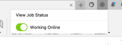

Okay, but could I just delete the local files manually?
Message 7 of 9
RajkumarIlanchelian
@hieiswordflame If you go into your job status and do not have any pending uploads, then yes you can go ahead and delete the cache. (Just for kicks, please back up that folder just in case. I know it will not be a problem but just saying).

hieiswordflame
Thank you! It worked. I'll keep the backup for a few days, just in case.
