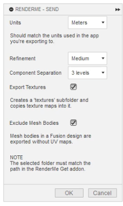

 And this is what it looked in the Classic Theme like before I converted the info to tooltips.
I later noticed that the textbox below units also partially covers the dropdown below in the new themes.
I can try to reload the old code just to get  a screenshot with one of the new themes applied if that's important.
