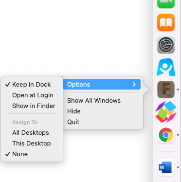

mputaala
@Phil.E: In my case, I'm able to replicate the issue by assigning Fusion 360 to a virtual desktop other than the one in which it was initially started. There are two ways to trigger the issue:
- Drag Fusion 360 to another virtual desktop after pressing Ctrl-↑
- Select a virtual desktop in the Dock options
On the other hand, starting Fusion 360 on one virtual desktop and keeping there appears to prevent the browser from disappearing. I've selected None in the Dock options (see the below screenshot) and then started Fusion 360 in an otherwise empty desktop (restart of the application was required, i.e. it wasn't enough to just make that None-selection). That seems to help, and I've not had the problem for a little while. Am currently running MacOS 12.2.1, but the latest update did not seem to have any effect on the behavior.
Hope this helps your investigation.

chrisQX8DX
just an update, funnily enough i had 'None' selected and was getting the issue .. then i have set it to 'All Desktops' and the issues dissapeared. Now i just checked and 'None' is selected again although i had set it to 'All Desktops'.
In any case the issue is solved for me now, but it would be great to be able to assign Fusion to a specific Desktop without the issues. I think it's definitely a bug rellated to Apple spaces.
