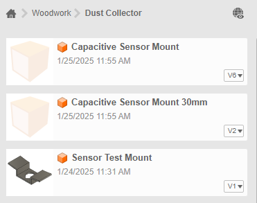

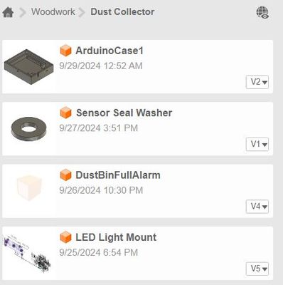

I opened F360 on the laptop and there, only one of the 2 broken projects had a missing thumbnail:
Back on the desktop, both still broken:
Neither show correctly on the Web interface.

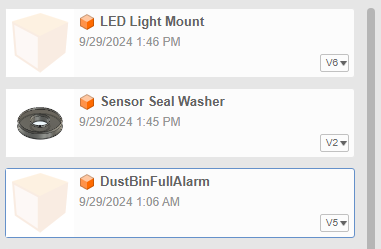

Looking at the LED light mount for example, on the laptop on the laptop is version 5 with the thumbnail. On the desktop it is Version 6 without the thumbnail. So the thumbnail went missing for this one on the desktop and not necessarily on the laptop.
For the other one DustBinFullalarm, both v4 on the laptop and v5 on the desktop does not have the thumbnail.

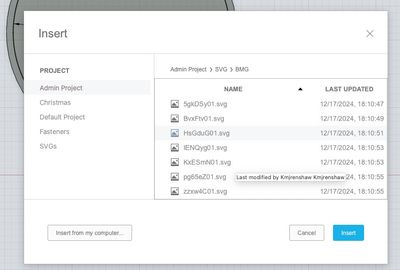

kmjrenshaw
Same for me. I can't see my SVG thumbnails
