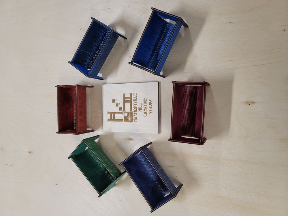

I am trying to find out how to bend a flat extruded body where the tabs on the extruded body insert into slots on two end pieces. Pictures are included (F360 bodies, finished product). I have done searches but may be using the wrong search parameters and have come up with nothing that quite fits my need. Any shove in the right direction would be much appreciated.4.0 - F360 Render - Business Card Holder.PNG7.2 - Picture - Business Card Holder.jpg

You did not supply your model so I had to create one.  The Screencast will show the process.  If you would like to view more information on this process, check out this Blog Article and Video.
The model I used in the Screencast is attached.

Thank you MOST kindly. Very helpful!
