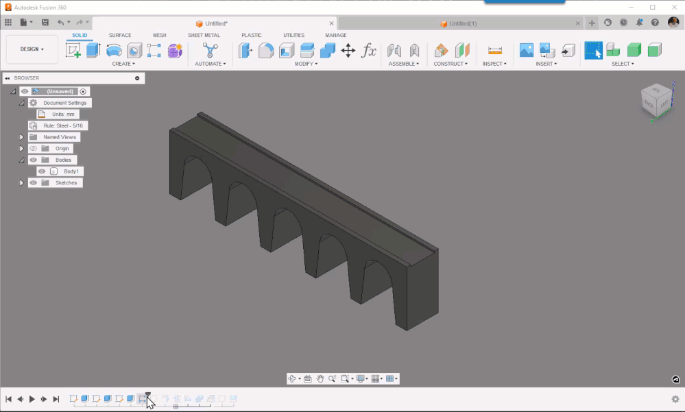

Hey community.  I am an absolute beginner. I want to draw a bridge with arches for a model railway layout. when evertything is drawn I want to bend the bridge in a certain radius in order to get the arches bended and shrinked (the inner radius) in a correct way. Does anyone have an idea how to manage this? thx adn br

Hello CadWhisperer. Thanks for the reply. I have watched a lot of tutorials and they are really great. but I can't find what I'm looking for. What I want to achieve is something like the attached file. I am thinking about to draw it straight and then to bend it. But I don't Have any idea how to bend to respect a predefined radius. BR

You should model your bridge directly to the shape and curve you desire, that would be the efficient method.  You seem to have your heart set on creating the bridge and then bending it to the radius you desire.  To that end, I created a sample model to show that is possible.  Of course I just created some dimensions to demonstrate.  Model is attached.

THIS is exactly what I was looking for. u made my day.

Thank you for your reply. For me this is all a bit tricky.
U use sketch 4 to draw the arch with the small extension. The next step is to unfold this bow and I don't know how to achieve this. And for the last three steps, I don't know how to do it either.

I used the same model that I sent to you originally to create the video since you are familiar with it.
If my video explains the process and answers all your questions, please remember to select the "Accept Solution" icon at the bottom of my Forum post to acknowledge your question has been answered and to help others find the solution to similar questions.

@jhackney1972 Something I did not see in the video, or in the model you attached is a correct K-Factor.
If you are looking for a specific inside or outside radius of the bent object, you need to make sure the K-Factor in the sheet metal rule is either set to 0 or 1.
