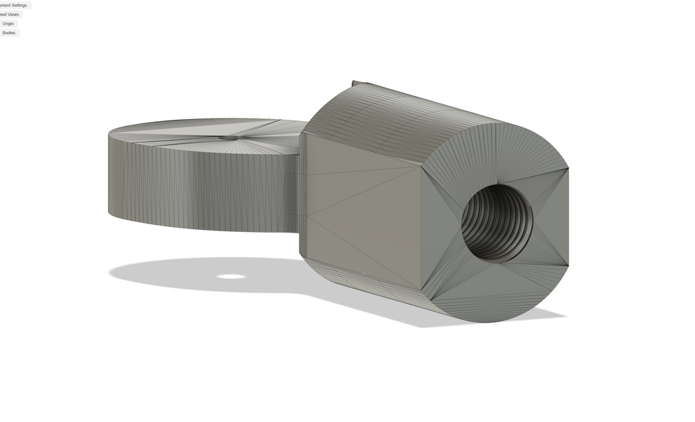

Hi, well so near yet so far!
I found a tutorial on how to upload the xml and have Fusion recognise it (yaay) so selecting the 3/8 BSF setting gets a result that is so close to correct but will only do a turn and a half before locking up.  I tried each of the class settings but not much changed.  looks like thread pitch is not quite right (see photos) but I am not sure what to adjust to sort it.  I am presuming it will be something in the xml file.
Thanks for taking a look
This is what Fusion produces with the 3/8 BSF settingThis is what Fusion produces with the 3/8 BSF settingThis is what the correct thread looks like (manufactured part)This is what the correct thread looks like (manufactured part)How the two threads compareHow the two threads compare
Message 11 of 18
MRWakefield
Ok, so it looks like the manufactured part isn't 3/8" - 20 BSF. I suspect that it's M10x1.25.

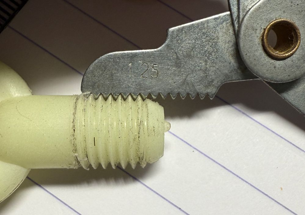

I tried an M10 x 1.25 but that didn't work either, according to Google etc the thread in a "bank stick" and other fishing items like landing nets are generally 3/8 20tpi (although new sizes are coming out from other vendors) pretty confident this is 3/8 though I have also seen it written as 9.52mm x 1.27 pitch (odd that 1.25 tool fits so well!).  It may be that I need to do an offset but gonna have to work that one out.  Seems when Fusion does an update it forgets where your xml files are on a Mac and mine just updated so going to have to start again.  Thanks again.
Message 13 of 18
MRWakefield
Bear in mind that 3D printed threads tend to need 'adjusting' (hence the reason for the post I linked to). If you don't, then they very likely won't fit. So, if you tried a 3D printed M10x1.25 then this would be a very likely reason it didn't fit. No one uses BSW and BSF any more for new products, they're still around only as support for old equipment etc. It might be that some are still using 3/8" BSF so they fit old nets/handles but I'd be quite surprised if they were. They could be 3/8"-20 UN but because that 1.25mm thread gauge fits so well I really do think it's M10x1.25 (mind you the difference is only 20 microns per pitch). If you can get hold of an M10x1.25 bolt/screw or screw plug gauge to screw into the mating part then this would help confirm what it is (or isn't!).
Yes, 3/8" = 0.375" = 9.525mm and 20TPI = 0.05" Pitch = 1.27mm Pitch.
Can you measure the thread OD that white plastic part and tell us what that is?

Message 14 of 18
peter_e_stokes
Hi Thanks again,
Most bank rods, landing nets etc here in UK will be the 3/8 thread, I bought two shorter bank rods a couple of weeks ago and they were 3/8.  there are attempts to bring in different sizes but the universality of the 3/8 size makes it an up hill struggle.
The thread on the white piece is 9.55mm OD
I will see if I can buy some of the M10 1.25 bolts

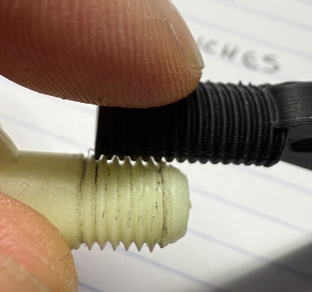

Message 16 of 18
peter_e_stokes
Good evening!
Fancy you being in bedfordshire, you've probably heard my screams of frustration as I am in St Neots!!
Not had time to get stuck in till this evening and managed a couple of hours. So I got a normal bank stick with brass threaded piece and that measures 9.22mm a bit smaller than the white plastic rest which was 9.52mm.  So I tried to amend the threadfile for BSF 3/8 so major dia is 0.3622in (9.2mm in imperial (I hope)) but when I try to put a 3/8 thread  on a cylinder the drop down for size still only shows 0.375in.  I figured it out though, I needed to change the <Threadsize> field to get it to show correctly, though I guess setting major dia to 0.3622 would override the Threadsize field?
Is there a breakdown anywhere of what the fields in the threadate.xml files mean?
I'm hoping that printing at 9.2mm and not 9.52mm might accomodate some spread from the 3d print process.

peter_e_stokes
And just like that, the printed thread screws in nicely (I printed a small stub with thread and now printing finished rod rest)
I learned so much doing this and as frustrating as it was, so happy to have finished it, even though I can buy a rod rest top for a couple of quid, as a vehicle for learning it was great.
