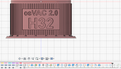

Hi guys,
I have something weird here.
You can see the time marker right before a "move" in the time line. I marked the move along with another 3 items as "suppressed".
If I move the time marker one step, some bodies will move - despite the fact, that the "move" is supressed!!
I right clicked onto the move and I can see
Any ideas?!

HughesTooling
If you change the move type to Translate, unsuppress then suppress it works as it should. Personally I would never use a Free Move in a parametric design, you could always just edit the distance with a translate rather than suppress.

Even my most complex design don't even have 1/10th of the user parameters you have in this simple design. It makes absolutely no sense to spend that much time trying to create a user parameter for almost every dimension in the design.
Perhaps you might find it difficult to easily identify dimensions otherwise, but one of the reasons for that is that your sketches are overly complicated. Fillets and chamfers that can be applied as solid features should not be part of a sketch. In fact those features should be applied as late in the timeline as possible.
Suppressing 10+ features in the timeline is asking for trouble.
Sketching with overlapping sketch lines is bad practice and should be avoided:
That's just the first three timeline items 😉

Probably the reason, why I suppressed features in the timelineis not obvious:
What do you do if you want to do something similiar of something you had done before? You copy/pasteNew the component and then you remodel it. While doing so, features later in the timelime may not fit with the prior changes. But you do not want to throw them away, while you remodel. Because there is no copy/paste for features on the time line. So you suppress those features while you work on the other features.
