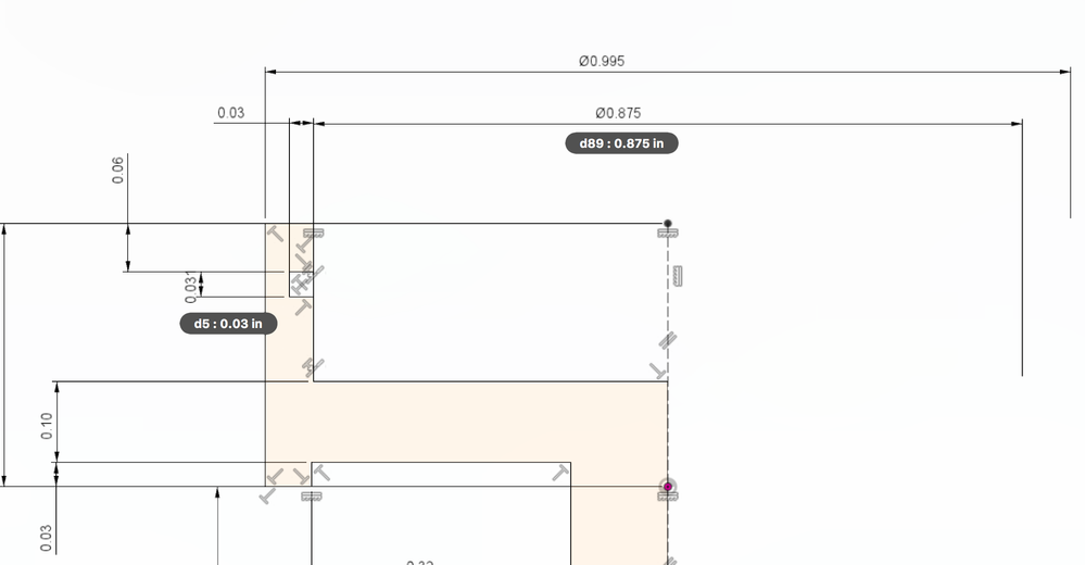

Your Base sketch contains dimensions d89 and d5.

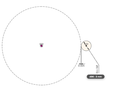

The sketch for the serrations includes d96

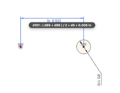

With a little bit of math you can dimension the position of the circle without having to use any projected sketch elements or relations to existing geometry:
In general this takes a little longer to set up, but generally is very hard to break.
