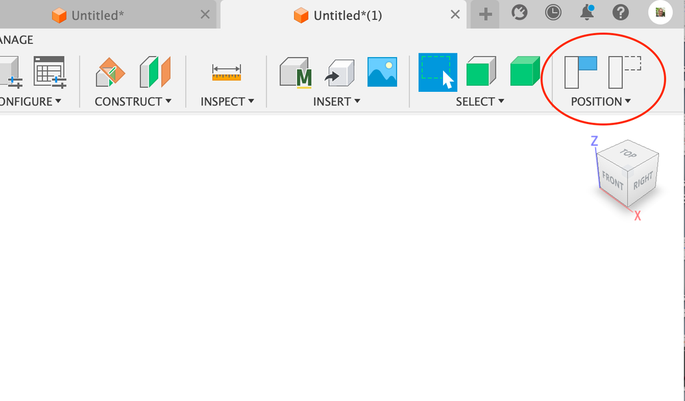

This is expected behavior.  Component moves (whether by dragging, Align, Drive Joint, Animate Model, etc) do not generate timeline entries.  This is considered a transient state, and in the upper right, you will see this UI:
This is telling you that the design is in a "component moved" state.  You can choose to Capture this position, or Revert it:
Choosing "Capture" will then put a Capture Position timeline entry in your timeline, which will be preserved.  If you do not Capture it, and you roll the timeline marker forward and back, the transient component position will be lost.
This is why most everyone on this forum will recommend not using Align or Move on components for important positioning actions.  Instead, use Joints to position one component relative to another.  A Joint is stable across geometry changes, where Align is not.  In your scenario, even if you had Captured that position, if you would subsequently change the height of the "base" component, your relative positioning of "moveable" would be lost - it would be in the same position, but no longer correct with respect to the geometry in "base"

I can't really tell what feature got added to your timeline, (because the red line covers part of it) but it looks like this is the Capture Position feature I mentioned.  Yes, it will appear, if you capture the position (either after the command, or by checking this box in the Align dialog):

and, the third, which illustrates the difference between Align + Capture Position and Joint.  When I modify the first component after using Align, Component2 does not change its position.  This is because the Capture Position only records the relative position change of Component2.  However, if Joints are used (and they are pretty easy to use, IMO), the relationship is between the two geometries selected, and Component2 does update its position if Component1 is modified:
