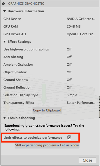

Are you using the "Limit Effects..." option in the Help > Graphics diagnostics menu? This is one easy way to get some performance out of the preferences in Fusion 360.
