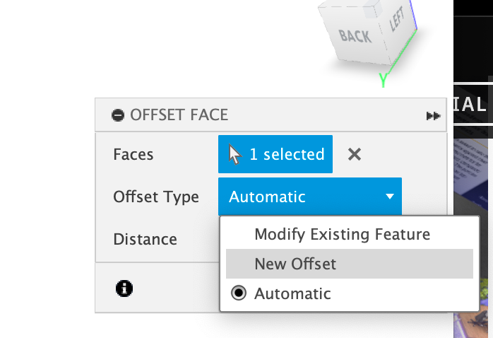

Hello, I am new to Fusion.
I just finished a model that I had to scale and then pull out a side to fit my desired goal. If I only pull the selected face before scaling, only the side I need to change pulls. But If I do it after scaling the model, the 4 sides of the model pull and not only the one I selected.
Any tip would be helpful, thanks you
270 Views
jeff_strater
Try setting the mode for Faces in Press/Pull to "New Offset" instead of "Automatic".  Or, even better use Offset Faces instead of Press/Pull.  I am not a fan of Press/Pull...

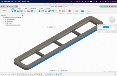

rodrigomedinaCQDUJ
Hello, thank you for your answer. I tried it and still same issue 😞
jeff_strater
please share the design.  I suspect it has something to do with the fillets, but a simple case works fine.
Jeff Strater
Engineering Director
rodrigomedinaCQDUJ
Thank you for your help. I actually just realized that scaling was also messing with my model. Scaling it (from full size to half size) ruins the fillets and other things. I will work out reducing the x size without losing the filets and other features of the sides and then I'll use the offset tool. Then your solution works like a charm
