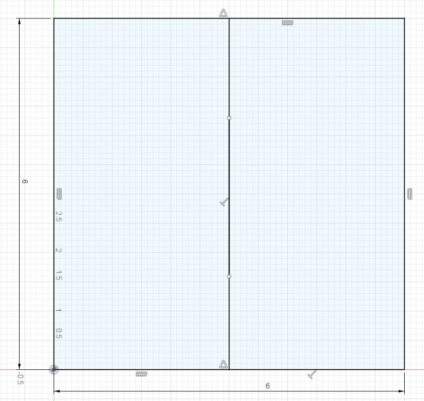

As of the most recent update, I've been having an issue where:
- I'm in a sketch and draw a line.
- I go to dimension that line based on another line in the same sketch.
- The value I enter (say, 12") places my line 12" away from the referenced line - but on the opposite side of the line than where I'm trying to position it. The best way I can describe it besides that would be that it's as if I typed in ' -12" ' instead of ' 12" '.
I will often have to save and restart Fusion360 to fix it, but even then it doesn't always work and I'll have to resort it again. This has been happening ever since the most recent update and is happening semi regularly (5-6 restarts within an hour, for instance, or sometimes it's every 5th line or so that I sketch). Additionally, this has been also happening to my colleague as well.

Sure - I just created this simple file to illustrate it. If you go into the sketch, try to dimension the non-constrained blue line.
For instance, try to make it 2" to the right of the vertical centerline. When I try to do it, it flips to the left side instead.

jhackney1972
Using your Version 1, the first model you posted, I also cannot replicate the "flipping" issue.  I show my process in the attached animated GIF file. Am I doing something different from your process?

You have an invalid dimension.
I saw this in your video too.

There is another discussion thread running on this issue..
I was able to reproduce the issue from scratch on Windows 10 machine.
It is an obvious bug in Fusion when set to Feet and Inches.
An easy way around the issue for now is go ahead and Enter for the default dimension - Do Not attempt to enter your desired dimension. After the default dimension is placed you can then Edit to your intended dimension.

tom_bell_autodesk
This issue is logged and we are looking into it. In the meantime, you could use decimal display instead, as the issue is specific to fractional (and architectural).
