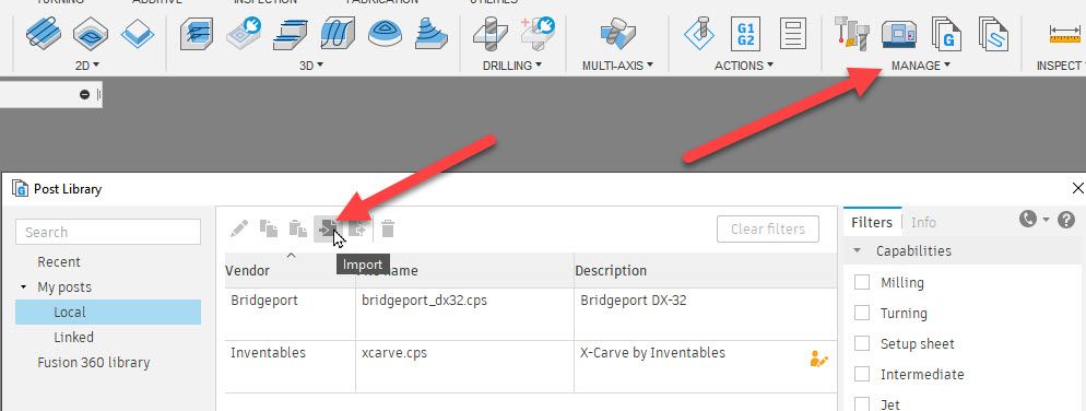

Had to rebuild my laptop, thus reinstall Fusion 360.  Following this link https://knowledge.autodesk.com/support/fusion-360/learn-explore/caas/sfdcarticles/sfdcarticles/How-t... to remind me how to add a post processor for my desktop CNC.  The interface for doing this has changed and the how-to has not kept pace.  Any ideas how to add a post processor when your machine is not in the pre-set lists?

This should do it for you if you have a post processor file (cps) to import.

Bingo.   I'll have to boot up the wee machine to verify, but that looks to have done the trick.  Thank you.
