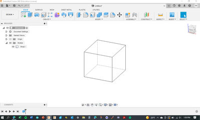

I've been having a problem recently. As soon as I start a new design, an active component is created even when there are no solids. Since it's active and it's the only thing in the design, I can't get out of it and everything has that translucent, wireframe look. I've gone into Preferences>Design and turned off "Active Component Visibility" and my opacity is at 100%. Is there a way that I can fix this?

1. each design starts with an active component (Unsaved)
2. Check your Display settings

3. The setting in the preferences means that only the active component ( Black DOT) is displayed "fully" and the others with reduced visibility.

At the bottom of your screen go to display settings/visual style and select shaded.
jumpcitybreck83D63
That fixed it, thanks!
