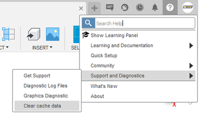

krishtechnoconsultants
Hello everyone,
I recently encountered the same issue except my folder was 50.2 GB in size.
Solution is quite straight forward.
This folder has the dump of all the crashed/unsaved designs/deigns not yet uploaded to the cloud.
To sort this out without tampering with installation files, it is necessary to clear cache data as shown below.
This will restart Fusion , but at the end of it, you will be smiling at all the space you made.
Message 18 of 35

PeterObermeierFre
Thank you for this information. I was not aware that there is a way to clear the cache.
Before clearing I had 4 GB in my Autodesk web deploy folder and after clearing and restart I have a new folder in Webdeploy production with 3.3GB which is resulting in 7 GB, which was a real surprise.
Looks like this cache clearing is not a solution or it is a solution for another problem.
Anyway, good to know that the functionality is there.
I will continue with a manual deletion of old production files.
