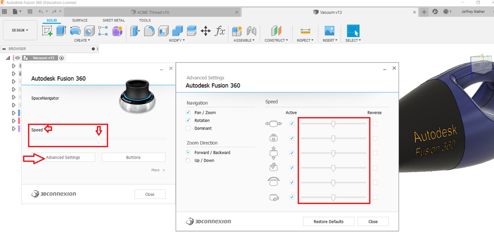

Hey guys. So I have been trying for days to figure out this problem. Mu Spacemouse rotates the views in Fusion in slow motion. The preferences in Spacemouse driver does not effect the speed in fusion. I tried downloading all drivers reinstalling, rebooting. Nothing works. All other apps run super fast with spacemouse and settings in preferances do effect them except fusion 360. It's not graphic card issue because I can select orb tool and spin my parts super fast.
Been reading for hours and watched many videos which shows 3d mouse settings inside Fusion 360 which I do not have. 3DConnexion SpaceMouse does not have plug in for Fusion 360, only Inventor, Autocad and Maya

TheCADWhisperer
Can you post image similar to this for your 3D Connexion device?
(I have also found that it is helpful to right click Calibrate every morning.)
