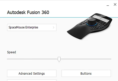

There is a set of settings controls provided by 3Dconnexion, have you seen this?
The advanced settings and buttons settings are pretty detailed wrt motion, speed, button assignments, etc.
