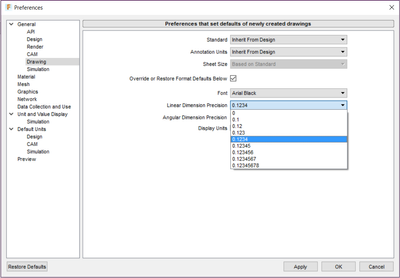

Have you tried going into Preferences under General > Drawing and changing the linear dimensional precision? I wasn't able to reproduce the jump back to 0.010" by lowering the precision, but I think it's worth a try if you haven't already done that yet.

Also changing the precision doesn't change the tolerance default, here set to 5 places and still +/- 0.01"

Yes, you are correct on both counts.  The precision issue looks like a bug.  The resulting dimension is correct (provided I have trailing zeros turned on) but the values displayed in the Dimension Edit dialog should also reflect this precision.
