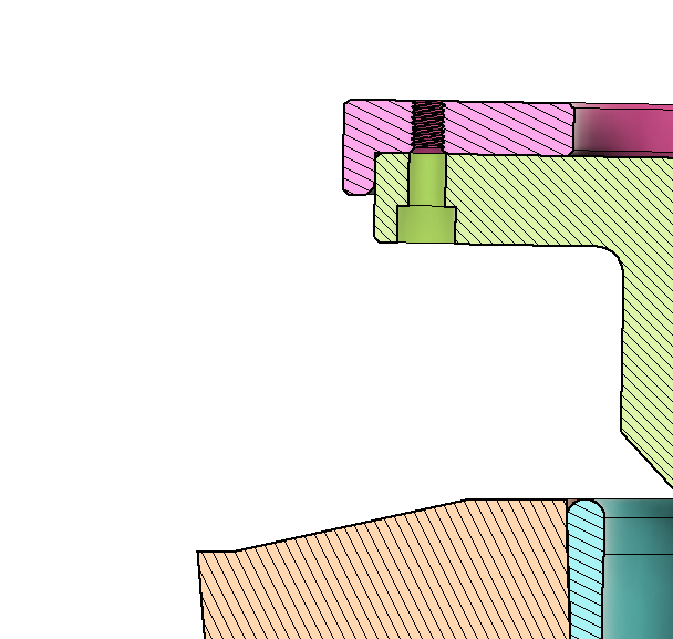

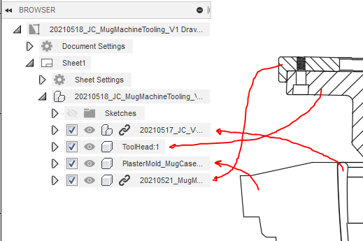

I am setting up a 2D drawing with a section view to send out parts for quote to a vendor. Some bodies and components in the section view are not showing cross hatching. I've seen a few forum threads about this issue, but don't see any of those solutions working for me. The only way I've got the cross hatching to work is if I move the section view dividing line off the middle of the design, but I can't do this for the drawing as there is only one section view slice orientation that will work for this drawing.
What I find strange is that two of the 4 bodies have cross hatching and the other two do not. All 4 bodies are revolved from a 2d profile sketch. 2 bodies are inserted components (one hatches one does not) and 2 bodies are components in the base 3d design (one hatched one does not). I am struggling to identify any similarities with the bodies that don't hatch vs the ones that do.
Things I've tried:
  • Rotating the bodies on the Y axis (into the section as shown)
  • Rotating the non hatching bodies on the Z axis (the central axis that parts have axial symmetry on)
  • Adding extra extrusion features to the revolved bodies that aren't showing cross hatching. (I noticed that the only bodies not showing cross hatching had just one revolve command to make them while the bodies that did work hat extra threading, bolt holes, etc)
  • Moving the section cut off center (does work as mentioned, but not a useful section for the drawing)
Sorry I can't show the whole design, but have screen shot some semi-useful portions
