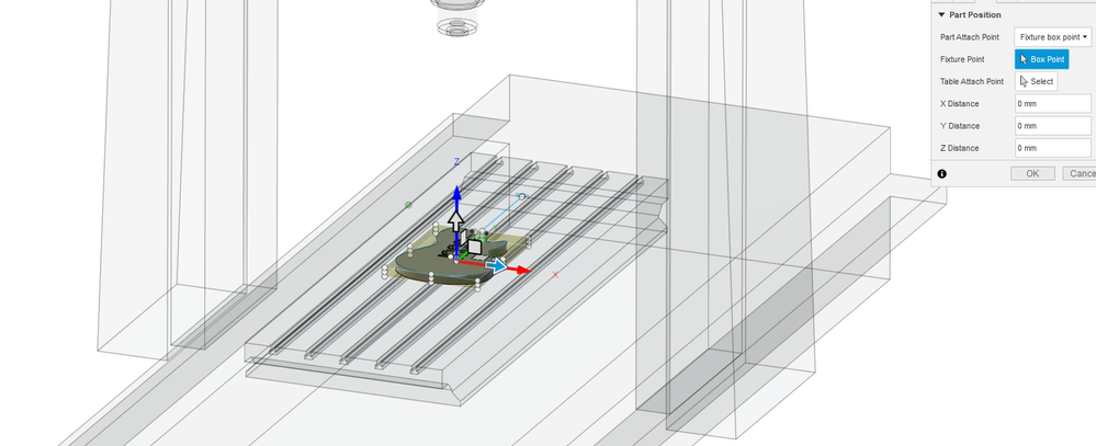

I am trying to align the X,Y,Z coordinate system to that of my CNC machine. Z is up and located correctly, but X & Y are reversed. I need to the X-Axis to go East/West and Y-Axis to go North/South. I have gone under preferences to see if I can swap X & Y axis. I have even gone as far as to click on the "face" and redesignate to to "Top/Front" with no results. I have included a picture of what I am trying to accomplish. Any help would be greatly appreciated. In the picture I need to swap the X & Y axis locations.

I am puzzled, if you model on the X-Y plane, the axis created in the Manufacturing environment (CAM) come in correctly. If you use a different modeling plane, all you have to do is redefine your axis in the Manufacturing Setup routine. Please see screencast.

In the manufacture workspace click your setup and edit, then change the WCS orientation to select Z axis and Y axis or X axis, then define your face or edge for Z axis and define your face or edge for Y or X axis.

Im having the same Problem myself, My cnc y axis is longer than it is wider. Fusion Thinks the x and y are opposite of what they really are. When i do my setup on a drawing i set it up the way i would on the cnc but the machine has x and y flipped the way they in real life.

It sounds like it's just a matter of selecting which is the X axis in your Setup. Could you share your Fusion file?

So Ive been playing with it all afternoon and i did try and fix the model to follow the cnc y and long side of the machine. But the issue still remains no matter how my model/stock is fixed up or the points on the model. I believe the cnc machine in fusion isnt set up correctly. The x and y need to be switched. Unless i need to not look at the rendering of the machine and go with it?
You might want to mention the machine you are using and the post processor. Your file contains neither.

Sain Smart Genmitsu PROVerXL 4030 with the 1000x1020 Extension kit.
Ignore the machine, imo, or change the alignment of the part on the machine.
In truth, 99% of 3 axis work can be done without a machine config and machine simulation

....there is. Select your Z and X from the model, it will orient the part to the Z and X of your machine

WCS Orientation is available at every level. Can you share a file and/or images that detail what you're running into?
All you need to do in your Setup is turn on "Select Z and X orientation, and select the plane that is normal to Z (to establish the Z orientation) and then an edge that runs along the "X" axis to align the X. Alternatively, you could do Z/Y and select an edge that runs along your Y axis.
