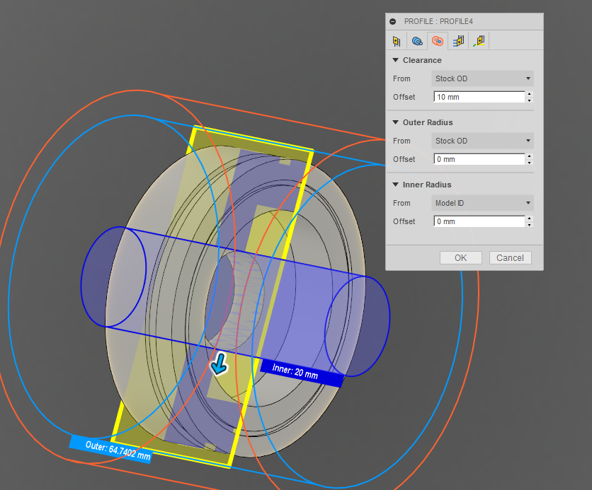

When using from selection for the inner height there seems to be some issues.  As you can see in the attached image I have from selection and the inner radius indicator is not showing correctly.Autodesk_Fusion_360.png

Have you selected the model on the setup, just came up in another thread and I though you might have the same problem

Thanks I just double checked and there body is selected in the setup.  So not sure what is up with it.

Can you attach the file it's a bit difficult to see quite what the part looks like in the picture.

It looks like some of the options for ID don't work. If you have a hole through the part and select Model ID it picks that up ok.
But using selection just picks up the model ID and ignores the selection.

Also grabbing the manipulator and dragging when in from selection mode does not work correclty.  When I drag up it get goes down and dragging down goes up.
Lonnie.Cady
From selection actually does not work for the OD either.
