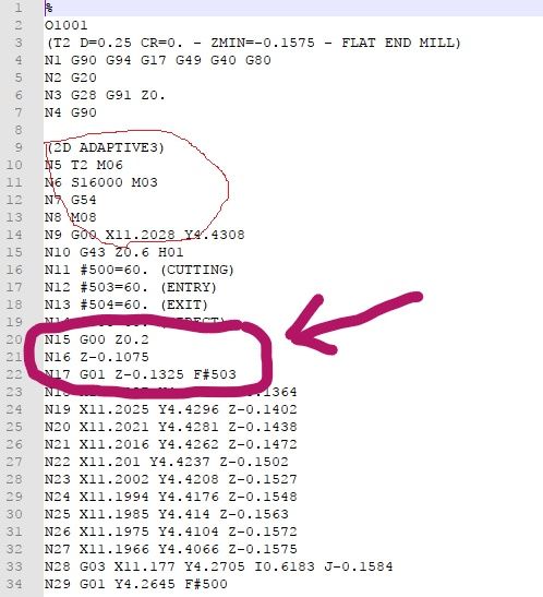

I've had this issue before and changing the CAM helped but it would be nice to trust the CAM that fusion is exporting without always having to check the g-code. To sum up my issue, fusion is exporting g-code in which there is a G0 command to below the stock material top surface. This means my CNC will execute it before the spindle is up to speed. Is this a bug or is there something I'm doing wrong?

N16 is where the error is. Tool moves to Z -0.1075 before the first G01 command is issued. So the machine doesnt wait till spindle is up to speed before executing.
Message 6 of 13
trober14
Its a home built machine using linuxcnc. I post to EMC2. I dont believe its on the machine or post side. Another commenter tried posting to Mach3 and the error was still present at N16.
Attached is a similar part where the g-code generates correctly. The machine rapids to Z0.2, the next command issued is a G01 to Z0.0394 with a plunge feed rate of 5in/min which means the machine will wait till the spindle reaches 16k rpm before executing this line. Then the tool plunges to Z-0.9375 with the same feed rate.
Fusion is exporting code with that G01 missing causing the machine to plunge into work piece before the spindle is up to speed. I would think it was an issue with my CAM skills if it happened regularly but I see this only 1 out of 50 programs.

Problem is in operation settings for tool approach on first plunge. Vertical "lead in" was set to .025.
In above G-code, look at the lines N15 - N17, tool does exactly what was programmed in Fusion.
N15- tool rapids to Z.2,
N16 - tool rapids in position before given vertical lead in of .025
N17 - lead in move is executed at given feed rate,......... Z-.1325 minus Z-.1075 = -.025 ( .025 vertical lead in )
Problem goes away when you change vertical "lead in" value in Fusion operation to prevent rapid plunge into the stock, I used .1 and that cleared stock in rapid tool approach as shown in screenshots of my first reply to this thread.

I guess my question is why doesn't fusion use the plunge feedrate when entering the material? The logical way for me to interpret the CAM settings would be as follows
N15 tool rapids to Z0.2
N16 Tool plunges to Z-.1075 at F5
N17 Tool performs the 0.025 lead in
I know there are ways to make this work. This just seems like the intuitive way for someone to set this program up, yet it causes behavior that I don't see on any of my other programs.
