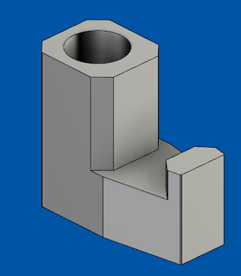

Lighting Control?
In the attached pictures, you can see how the lighting changes as you move the part around. This is cool for rendering, but utterly useless for CAM. We need to see edges and points properly, not that easy to do with the current lighting configuration. Any chance of getting an option to turn off all shadows in CAM mode (or any mode for that matter)

Lighting Control?
Agreed.  CAM mode should be setup for maximum visibility of all surfaces.
