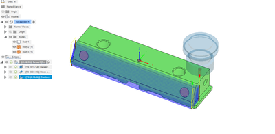

     Originally we were able to pick one surface and machine it very quickly and very effectively was definitely a highlight of Fusion360, now to achieve the same results we must pick boundaries and trim toolpaths. I've watched videos and read articles to no avail. Other people that use this function are struggling too. Please at least give us origainl funduanlity back.
Don't get me wrong, Fusion is an awesome software and I have been using it since 2014. If you want to improve something please see the photo.   tommyscustomshop_0-1731416952643.png

Old way pick these surfaces and boom off to the races it would only machine these surfaces by picking only these 3 surfaces. (Parallel,Scallop, Steep and shallow all use to work very well)
New way Result next photo
Here picking avoid surfaces
Here's result we never use to get the waterfall now we have to use slope and trim toolpaths

   Hello Thank you for the reply. Here is the link https://a360.co/48Lo3us . I do understand to pick entire model the link here is just a simple slide entire model is picked to Avoid Surface (Red) and the (Green) is Set to "machine surface" and we end up with toolpath waterfalling over edges even with "Contact point Boundary and Contact only" Checked and also unchecked either way tool path still falls over this stands true for all other 3d toolpaths now.     If you guys have access to the old way please pull this slide in and program a parallel pick machine surface and you will see the results.
     One other thing to consider is this is just a simple slide. When programming large molds such as large headlight lenses with many many multi faceted surfaces each time you are picking the entire model to add to a toolpath we are slowing processing time down.

Having taken a closer look at the file, another colleague and myself both believe the heart of this problem is that a change was made to allow the toolpath to 'touch' an avoid surface with a clearance of 0 on it. This can have the undesirable consequence that on vertical walls in 3-axis, the toolpath sometimes spills over. However, unfortunately, if we return to the previous way of internally defining a small avoid tolerance, there are other common and fairly simple cases that go wrong. We do not yet have a solution that solves both cases.
To overcome the waterfall effect, add a tolerance or fraction of tolerance sized avoid clearance on your model surfaces. Adding 0.0002 inch avoid clearance gave me the following result.
I hope this helps you overcome some of these challenges. We have taken notice of the fact that you find the waterfall on vertical walls problem significant, and that the lack of a simple workflow to select a small number of machine surfaces is undesirable. We generally allow feedback like this to direct our decision making processes, so thank you for engaging with us.

Hello, so when we add .0002 or even .0001 this is what happens the tool rises off the surface as seen in photo  (This part is just an example)  For some people this will not be an issue But in building silicon mold our vent depth is .0002 so you see this is an issue.                                          Is there a way for me to roll Fusion back to previous version?

1. tommyscustomshopwhen we add .0002 or even .0001 this is what happens the tool rises off the surface
I apologise, I gave you slightly the wrong solution to reproduce old behaviour. Just add a tiny tiny radial clearance, not axial clearance to the avoid model surfaces. It should work with a very small value, and if it's only radial, the passes shouldn't lift off of the surface the way you describe.
