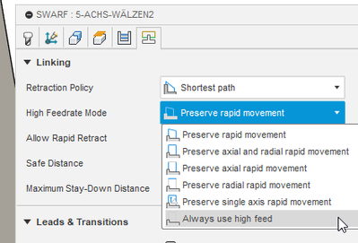

seth.madore
You have your "High Feedrate Mode" set to "Preserve Rapid Movement". It's possible that you're encountering a "dog leg" rapid of some sort as it repositions. Change it to "Always use High Feed" and let's see if that eliminates the issue.

MS11880
As suggested, I changed the "High Feedrate Mode" to "Always use High Feed" and ran the program using the old part and damaged mill.
The machines toolpath looks better but still, during the transition between stepovers it runs into the part:

MS11880
I have rechecked everything again. As it seems the TRT210 has shifted its position during the first crash.
That might also be the reason that changing "High Feedrate Mode" to "Preserve Rapid Movement" seemed to have improved the outcome but actually the tool was a couple of millimeters away from touching the part and therefore the transition that originally reached further into the part didn't seem as bad.
I have now changed to the Advanced Swarf strategy. I just ran the operation using the old mill and part and it seems to work just fine.
