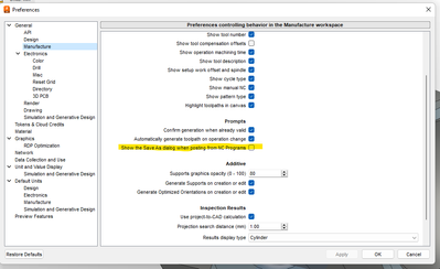

I have several machines, and i have more customers with repeatable work. I normally save the Gcode files to a general folder on the CNC machine in a customers folder and from there i go to the correct folder for the workpiece and store the Gcode for the correct opp in each of these subfolders.
With the old workflow i selected the CNC machines folder in the output, and after posting i could simple store the file in the required customer/workpiece folder with the storage dialog.
If i alter a file i am currently working on, (which was easy, since the last name was remembered in the post dialog) the machine asks me to use the updated file and I could move on.
Now it doesn't show the folder selecting dialog any longer, and i am forced to open the file explorer every time i post a file. Nor is the last chosen name remembered, it always goes back to 1001. For my workflow it's highly inefficient and with the previous versions i could still select the old methodoligy, but with the new and hip version of march, that most convenient version is gone and i am forced to put more effort in every single file i post for the machines.
Another thing that bugs me; i am using several machines and several PC's. In the passed the last selected machine was rememberd on each individual machine. Now it remembers the last machine used in my account. Not PC related.
Like i said, highly inefficient. (and frustrating too) Any change there is a tickbox anywhere that enables me to select the old type of file storage? I am far from a fan of the current itteration.

mattdlr89
In preferences you can use select it to use the Save As dialog when you post process. Does that help? I still don't think it will help with your default location though.
to3dornottobe
YES! That's what i was looking for.

to3dornottobe
Yes, with the old style active that feature is not there. i haven't noticed it before this update and i doubt if it's logical to have that tickbox there instead of in the dialog itself.
So instead agreeing to disagree, i guess i was not the only one who found this feature to be helpful.
