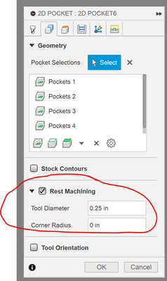

in reply to: seth.madore
The finishing cuts. on the final radius. I'm finishing with an 1/8 flat endmill. Radius are cut with a 1/2 and 1/4in. flat endmill. I'm trying to get rid of all the area the 1/8 in cutter has to go through to get to the edges to finish the radiuses. Trying to eliminate some run time! Thank you!!
Message 8 of 9
matty.fuller
in reply to: support4
You just turn on Rest Machining under the Geometry tab;
Message 9 of 9
support4
in reply to: matty.fuller
Thank you so much!
