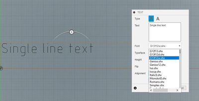

Have you tried using a Single Line Text ? Your cutter will follow the text shown in the image below using either the Contour or Trace toolpaths, the single line texts are found above the default Arial, so scroll up to find them.
Hope that is of some help 🙂
