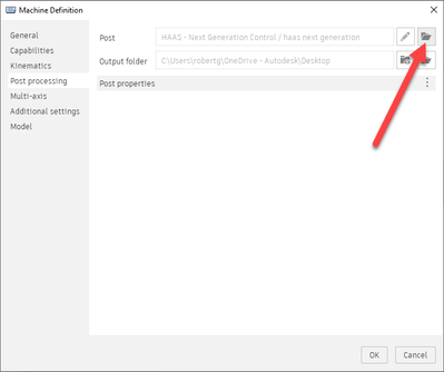

    Follow these steps to enable the functionality:
    1.  Edit your machine file and go to the post processing tabGeorgeRoberts_0-1728377159286.png
    2. Select one of our generic post processors by choosing the select optionGeorgeRoberts_1-1728377202738.png
