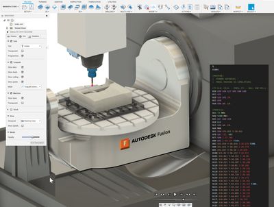

Looking for the latest post processors and machines updates? Look no further!
We are continually working hard to bring you updates and improvements to the many open-source Post Processors and Machines we offer for free, but those updates often get lost in the shuffle of other enhancements or big feature releases. This post aims to update you on newly added or improved post processors and machines, so you can stay up to date on what you use today or look for news so you can get the most out of Fusion.
