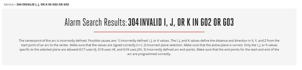

Hi All,
I am running into a very frustrating error on my mill. This only happens intermittently, and when I've "solved" it in the past, I usually have no idea what it was that actually fixed it. Basically, after posting the Gcode for a simple pocket, the program runs into a problem at the first G03, giving me an "invalid I, j, K" message (error 304). I've tried everything I can think of; updated the post processor to the latest version, changed tolerance levels in the machine, even changing to use "R" instead of IJK (that ran but made a diamond shape rather than a circle).
If anyone has an idea of what to do here, I would be greatly appreciative.
Here is a portion of the program code, with the error happening at line N70:

Hi @Windship ,
I found on Haas website the meaning of error 304:
I noticed that your postprocessor writes G3 only on the first circular movement ( N70 ) and not in the following lines.
Maybe your controller needs G code on each circular movement.
So you could try to add the highlighted line in your postprocessor ( in onCircular function ) :
  } else if (!properties.useRadius) {
    gMotionModal.reset();
    switch (getCircularPlane()) {
    case PLANE_XY:
Otherwise your controller needs to reduce the circular sweep configured in Haas postprocessor.
In this case you could change proper circular sweep parameter ( in the top of your file 😞
maximumCircularSweep = toRad(90);
Reducing circular sweep probably you could try to use radius "R" instead of IJK.
I hope this helps you. Please let me know.

Thanks for the suggestions. I was able to get it to work by updating the post file by changing
allowedCircularPlanes = undefined; // allow any circular motion (replaced “undefined” with “0”). That worked ok with the small circles, but I tried it on a larger part and it created a choppy arc, not bad on the part but the machine made a million tiny straight line moves.
I'll give your ideas a try too and see if they are a better solution.
