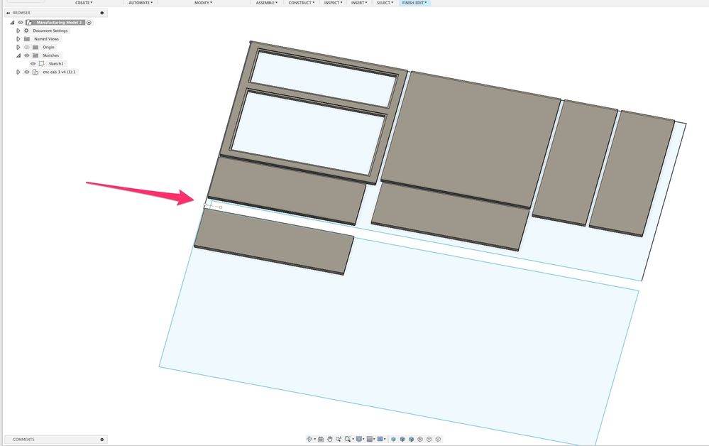

Hi as i said above I'm a fusion noob and I've been slowly teaching my self fusion 360 ive got my design finished and i followed Lars Christensen's video  Fusion 360 Tutorial - Align Arrange & Nest Assemblies - Season 3 - YouTube loved it taught me a lot. What i haven't been able to figure out is my job wont fit on 1 sheet of ply i need to spread it across 2 Sheets All help greatly appreciated.

Won't fit why?.... too long in one or more dimensions or does the total area of the components to be cut exceed a single sheet? Can you share your file?

the total components to be cut exceeds the space available on one sheet of ply. Please excuse my design etc ive only been learning fusion a short time

and what license do you have?

The included Arrange in the Manufacturing Workspace arranges components onto a single (as far as I know)  face, plane  or sketch. The paid Nesting add-in gives you all the Bells&Whistles. Now in this case you don't really need advanced features...Arrange has filled one sheet but had one leftover component..."no biggy" as we say here in Australia! Should you have a more complex arrange then you can at least investigate sheet use age with a two-sheet and bridge sketch:

Sweet I'm in Australia also. I thought it might be that simple but got confused when it came to saving the 2 sheets as separate Gcode (.nc)files so I can send them  to my CNC separately Thanks for your help.
