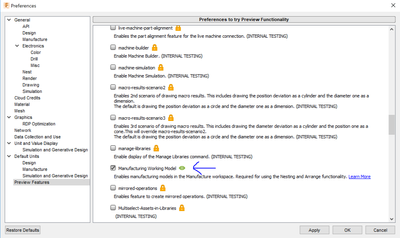

Have you tried out the Manufacturing Working Model preview functionality? I believe it could be perfect for what you need to do. It will let you edit a "copy" of the original CAD model in the Manufacture workspace to help when creating toolpaths. To activate it, go to your Preferences -> Preview Features and activate "Manufacturing Working Model".
If you want to learn more about it, go to this link: https://help.autodesk.com/view/fusion360/ENU/?guid=Fusion_CAM_concepts_mm_model_html . Keep in mind it's still not 100% developed (that's why it's a preview), but it is working well and should help you sort your issues out.
