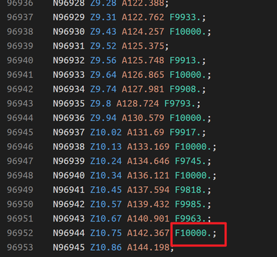

Well... Another problem occurs, now the feedrate is set to 10000.
How can I set these values to a reasonable feed rate?

It is expected now the feed rate is not in mm/min anymore its in deg/min so the feedrate value will be changing based on the toolpath points.
You can adjust the maximum feed here
I can see lot of copied machines used in the document. I would suggest to clear the machines in the document and keep a single machine in the document

Thank you for the information, Maximum feed rate , here it is!
