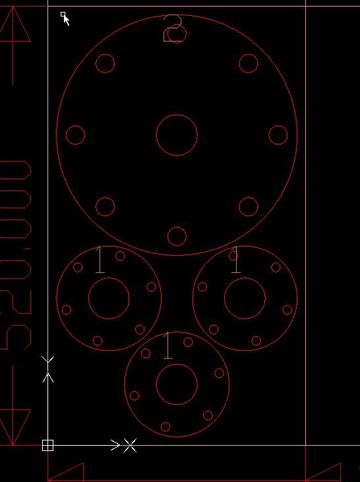

I then switched to a computer with a 2D CAD program and opened one of the DXF files.  ARRGHHH!  None of the manufacturing edits have been included in the export.  So the cutting pattern in F360 looks like this:
(the smaller flanges have bolt holes removed and bore reduced for machining after laser-cutting) but the DXF file looks like this:
The holes are there!  And the bore is the original diameter!  That's a whole day of my life I won't get back again and I can ill afford to lose the time on an exceedingly urgent job.
I'm not sure what the point of the manufacturing model is, if one cannot export what's visible on screen.    I cannot be the first person with problems like this.
